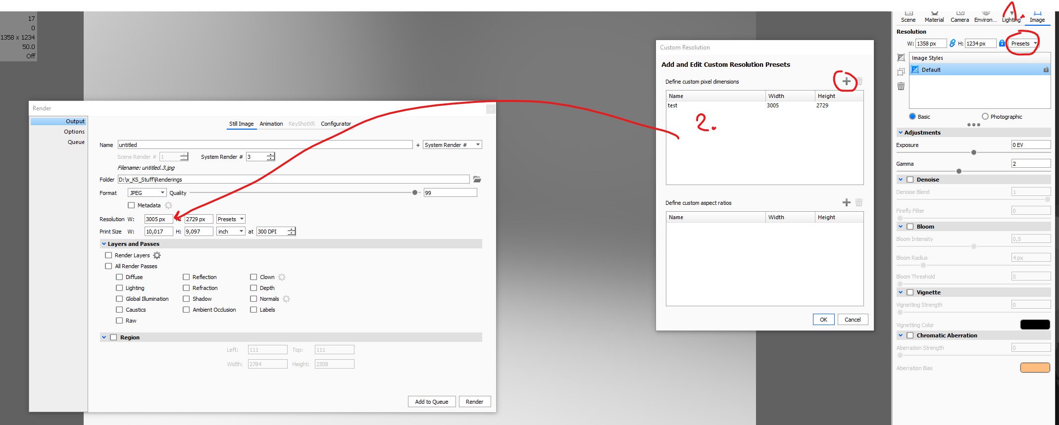

you have to first set a custom resolution as a preset and once you have that you put in the first resolution number in the render window and it will adapt your new ratio.
here is a quick screenshot showing it
O.k., I’ve tried that and when I choose my custom size, it just zooms into the object instead of adding additional space/width.
